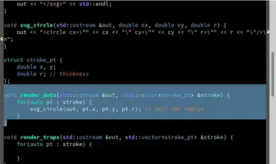

I accidentally pressed some keys in a buffer and created the permanently highlighted region shown below. What is this region called, and how can I get rid of it?

That permanently highlighted region is the secondary selection.
We deduced this in the comments to your question by putting point in the middle of the highlighted region and by calling M-x describe-char RET. You get something like the following in the opening *Help* buffer:
There is an overlay here: From 316781 to 316796 face secondary-selection

- 33,167
- 1
- 37
- 77
M-<mouse-1>. – Tobias Dec 28 '19 at 05:26M-<mouse 1>does not seem to help. (My window manager might be interfering with that by intercepting Alt.) – built1n Dec 28 '19 at 06:05M-: (delete-overlay mouse-secondary-overlay)to kill the secondary selection. In this case you can trigger the eventM-:by clicking once the Escape button and afterwards the:button. – Tobias Dec 28 '19 at 06:17M-x describe-char. Include the information emitted bydescribe-charin your question. BTW it looks like the methodrender_dotsis marked. Could be some C++ helper mode like semantic. – Tobias Dec 28 '19 at 06:26describe-charshows that it's part of asecondary-selectionoverlay, and(delete-overlay mouse-secondary-overlay)successfully removed it. Must've been my window manager, then. Feel free to write this up as an answer. – built1n Dec 28 '19 at 17:00(delete-overlay mouse-secondary-overlay)? The commands for the secondary selection defined inmouse.elall require a mouse event argument and are bound to someM-<mouse-X>. So they seem not so appropriate for your case. – Tobias Dec 28 '19 at 21:09
