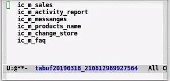

Clearly at the end of the lines there might be some random white spaces you not even notice. Not clearing them means replaced text is randomly like that:
ic_m_sales _inactive
ic_m_activity_report _inactive
ic_m_messanges _inactive
ic_m_products_name _inactive
ic_m_change_store _inactive
ic_m_faq _inactive
Clearing the spaces is even more boring than adding the suffixes.

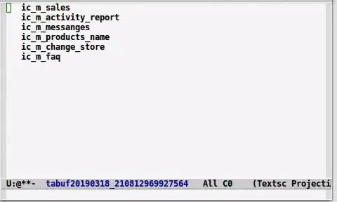

However, you can select the region to suffix and use the command C-M-% or M-x query-replace-regexp, then just type:
SPACE*$ENTER_inactive
Now you are replacing the spaces before the newlines, if any.
If the regexp above is inconvenient to type/remember, just define once and for all the function:
(defun region-suffix (r1 r2)
(interactive "r")
(perform-replace " *$"
(read-string "Enter suffix:")
nil 'regexp nil nil nil r1 r2 nil nil))
Now, when you select the region to suffix and type M-x region-suffix, you are prompted to enter the suffix and you are done.
If that is a common operation for you, bind the region-suffix function to some spare keys, e.g:
(global-set-key (kbd "C-x p") 'region-suffix)
