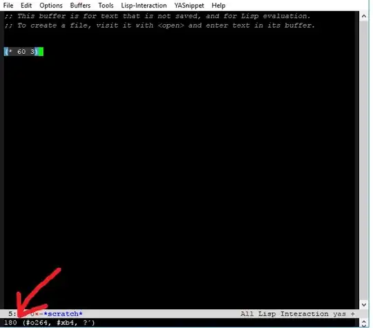

I want to do some arithmetic operation I do this:

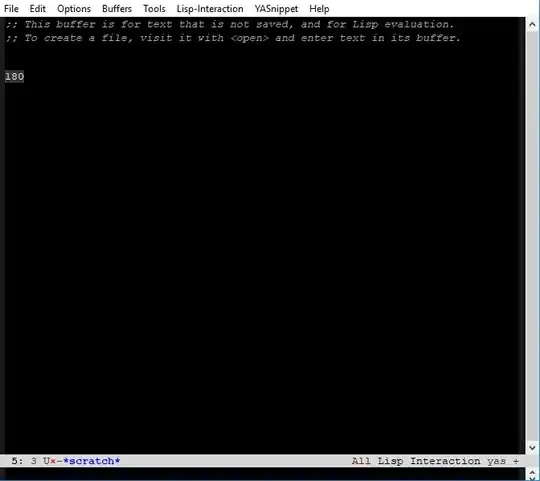

The result is in the echo area, but I want the result to be in cursor place in the buffer. Something like this:
How do I do this?
How do I do this?

C-u C-x C-e the result will be (* 60 3)180. But I need only 180 (as in my screenshot).
