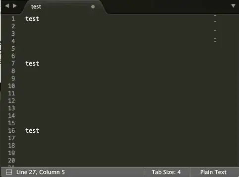

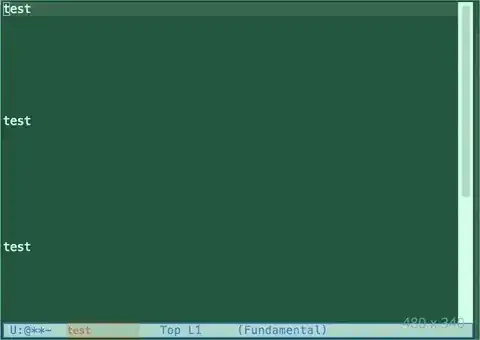

I use a lot multiple cursor and sometimes I have to select some words which are off the screen, in sublime text I do not encounter any problem, I can just scroll and continue selecting words. This, incredibly, seems not possible in emacs! When I scroll the previous cursors get messed up. You can see this behaviour in the gif I have uploaded. This may help: Let Emacs move the cursor off-screen
Sublime Text behaviour:
emacs behaviour:
emacs behaviour

    The point (cursor) in Emacs is always on the visible portion of the screen. If you scroll the buffer far enough that point moves off the screen, it is automatically 'bumped' such that it will remain in the visible section of the buffer. The answers to the question you link to suggest some work-arounds. However, as I understand it this behaviour is pretty fundamental in Emacs, without a simple fix. I don't think there is a straightforward solution for your use-case. – Tyler Aug 22 '17 at 13:40

In Emacs, the points (cursor) is always on the visible portion of the file you are visiting. This coded deep down in the guts of the program, so you won't be able to change this without a great deal of effort.
As a work around, you can use C-v and M-v to navigate back and forth from one multiple-cursor selection to the next. You can also hide all lines that don't contain a multiple cursor selection with C-'. In order for this last keybinding to work, you need to make sure mc-hide-unmatched-lines-mode is enabled, ie., put the following in your config:
(require 'mc-hide-unmatched-lines-mode)
