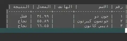

Screenshot to show the display
See the alignment in the Arabic table below how it is different from that of the table in English as ugly to neat. Is there any fix to get it right?

Using an Arabic monospaced font (Kawkab Mono) as kindly suggested by @Do didn't solve the problem.

Trying out Droid Sans Mono did improve the appearance but it didn't solve it completely and in a larger table the bad alignment would be much worse. I ran out of ways to seek a TYPICAL monospaced Arabic font that will fix it. I wonder if such a font does exist!!
Droid Sans Mono, you can see that the table columns get exactly one character off right after الاسم, and nowhere else. – Dan Feb 08 '17 at 22:13
