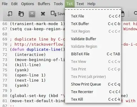

I'm very new to Emacs. I've installed AUCTeX version 11.89.4 using package manager (list-packages, select auctex, install it). It works, at least it shows compiled pdf result from test .tex file in local buffer after several C-c C-c strokes. Now I want to do some customization -- for example, showing result in external evince program. However, the more tutorials and docs I read, the more it seems to me that my AUCTeX installation is somehow broken:

TeX-view-program-list, which, as I've read, is used for setting view program. In fact, I have only three variables starting withTex, and all of them I've declared ininitl.elmyself:TeX-PDF-mode,TeX-auto-save,TeX-pase-self. - I don't have menu item
LaTeXwhich is mentioned here. I have only menu itemTeX, and there is no "Customize AUCTeX" submenu:

I didn't noticed earlier, but in fact I get error "no such file or directory" "tex-site" after running package-initialize when calling in from init.el too. It seems to me that the root of my problem is that I forgot to add the line (require 'auctex). After adding it, auctex finally works, I have TeX-lisp-directory and other vars, however, now I see the following warning in Messages:
