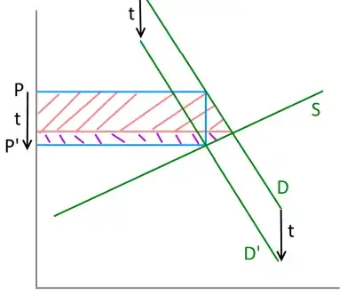

Here is an example with a fairly elastic supply curve, and a rather inelastic demand curve (forgive my drawing skills).
The demand curve, because of the tax $t$; shifts from $D$ to $D'$. The consumers will now pay price $P$, while producers will receive $P' = P - t$.
The variation of the surplus of each agents is quite telling : in ugly-rose, we can see that the consumers, who have an inelastic demand, loose a lot, actually most of the total loss of surplus. In the opposite, the purple area represents the producer's loss of surplus, which is smaller than the consumer's.
If the supply is inelastic and the demand elastic, than the roles are reverse, the producers ending up bearing a heavier part of the tax.
