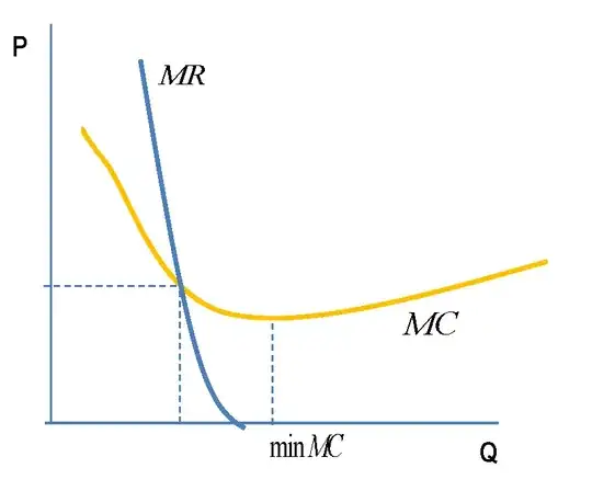

I understand that for any profit maximising firm FOC: MC=MR SOC: MR'< MC'
But suppose MC has a minimum beyond the point at which MR=0. So MR still intersects MC from above but MC is still falling (does this still satisfy SOC?). In that case would the max difference between TR and TC be greatest at some Q higher than where MC=MR?

This is something like
which looks pretty standard. As to whether Second-order conditions hold, in this post one can find a mnemonic about slopes, since the SOC is phrased in terms of derivatives of the curves shown in the above graph.
Since at $MR=MC$ the marginal revenue curve is assumed to cross the marginal cost curve from above, it follows that for higher quantities, marginal cost will be higher than marginal revenue. Given the previous suggestion as to how it is best to think about Marginal Revenue and Marginal Cost, I believe the answer to the question is easy.

Sorry I have been visualising the corresponding TR, TC curves wrong / mixed up with another topic. Where the MC minimum is is of no consequence to the problem, I see that now.
I don't have an issue with the marginal conditions, as the above answer points out they hold irrespective.
