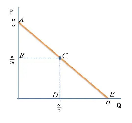

When the demand function is linear, $q = a-bp$, the only point were elasticity is unity is located in the midpoint of the demand curve (straight line). This is geometrical.
The demand line will cross the vertical $p$-axis at $p=a/b$ and the horizontal $q$ axis at $q=a$. For unitary elasticity (in absolute terms) we want
$$\frac{|dq/dp|}{q}\cdot p = \frac{bp}{a-bp}=1 \implies p=\frac {a}{2b} \implies q=\frac a2$$
So at unitary elasticity the corresponding price lies in the middle of the feasible price domain, and the corresponding quantity lies in the middle of the feasible quantity domain.
The related diagram is
The length $[AB]$ is equal to the length $[CD]$, and the length $[BC]$ is equal to the length $[DE]$. But this implies that the triangles $[ABC]$ and $[CDE]$ have two of their sides equal, so necessarily they will have also their third side equal. So $[AC] = [CE]$, which implies that the point of unitary elasticity $C$ is the midpoint of the demand line. Obviously, no other point can have unitary elasticity here.
