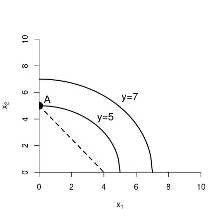

Regarding isoquants, you can find these by rewriting the production function as $x_2=g(y,x_1)$. In the generic CES, this is
$$ x_2 = \left(y^{\rho} - x_1^{\rho}\right)^\frac{1}{\rho} $$
These are linear in the case of $\rho=1$, convex in the case of Cobb-Douglas (where the function above is $x_2=\frac{y}{x_1}$, a hyperbole), and concave in the case of $\rho>1$. For example, select $\rho=2$ and you have:
$$ x_2^2 = y^2 - x_1^2 $$
which is the formula of a circle centered at $(0,0)$, with radius $y$. Normally, for production theory only $x_i \geq 0$ is interesting, which gives you the concave isoquants for different levels of $y$. The figure below shows an example, were for a given factor prices ratio, there is a corner solution (point A):
$\hskip3cm$enter image description here

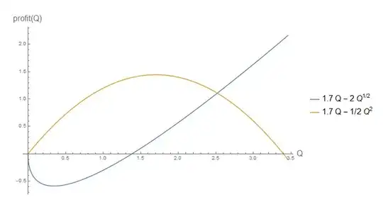

To see the same effect in a simpler example (not derived from CES), consider this:
$$ \pi(q) = p \cdot q - 2 \cdot q^{1/2} $$
SOC is $\pi'' = (1/2)q^{-3/2} > 0$.
Notice $q^{1/2}$ but not, say, $q^2$ as usual. Let us compare those two cases for $ p=1.7 $ on the plot to appreciate the difference. enter image description here
