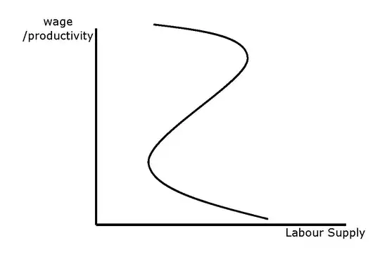

I think it was in one of Joan Robinson's books where a not just backward-bending but "mirrored S"-shaped labour supply was presented, referring to agricultural societies:
The rationale of course is that if your productivity is very low, you have to work very long and exhausting hours to even survive. As your productivity raises, what you want is not to work even more for the extra income, but thankfully to get some rest.
The empirical regularity is that most of workers in the world are away from the upper "backward" movement of labor supply - but in poor countries, they may very well be in the lower backward part. And I think this resonates with the information presented in @JohnL. answer. So chances are, you will find such preferences modeled in studies that focus on poor/developing economies.
