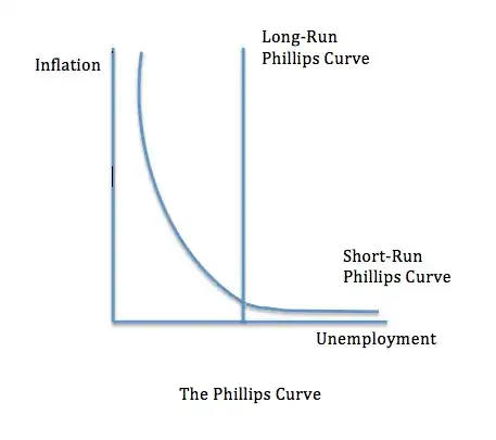

Recall that central banks use interest rate to control inflation by inducing spending or saving with decrease or increase in interest rate.
Also,note the theory proposed by the short-run Phillips curve.
Though this graph has some controversy in terms of its empirical soundness. It is the basis of how we tie interest rate to unemployment.
abstractly you can think of it as a "causal chain" being: $$\text{interest rate}\rightarrow\text{savings rate}\rightarrow\text{spending}\rightarrow\text{inflation}\rightarrow\text{unemployment}$$
Hope this helps.

  • I would say, after checking your link, that you are not alone in questioning the P. curve. In general, I think the thing is dead. – 123 Apr 07 '20 at 16:26
