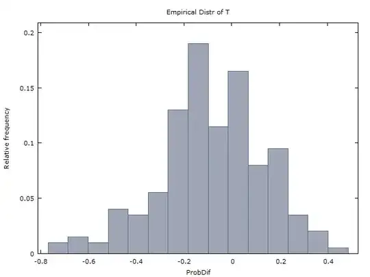

Nevertheless a rough simulation validates the Miller-Sanjurjo results as regards the distribution of the statistic. I simulated $200$ samples each of size $n=100$, of independent Bernoullis with $p=0.5$.
The empirical distribution of the statistic $T_3 = \hat P(H \mid H_3) - \hat P(H\mid M_3)$ has a sample mean of $-0.0807$ and a median of $-0.072$, with $62.5\%$ of the values being negative. The empirical histogram is
