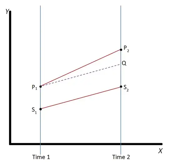

Difference in Difference is probably the favourite method in econometrics (although it requires bootstraping, i.e. correcting the data from self-correlation). It basically compares the evolution of two groups, from a point at which none is subject to the given factor to a point at which one of them is subject to the factor. A famous example is Card and Krueger's use of the method to investigate the impact of a minimum wage.
If anyone knows how I can scale down that picture, feel free to edit ;) – VicAche Jun 28 '15 at 12:45
1Difference in Difference does not establish causation. It establishes the possible size of an effect; but not the causality. – 410 gone Jun 28 '15 at 19:25
Quantifying effects is estimating causality, at least as OP understands it. – VicAche Jun 28 '15 at 21:24
