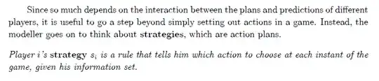

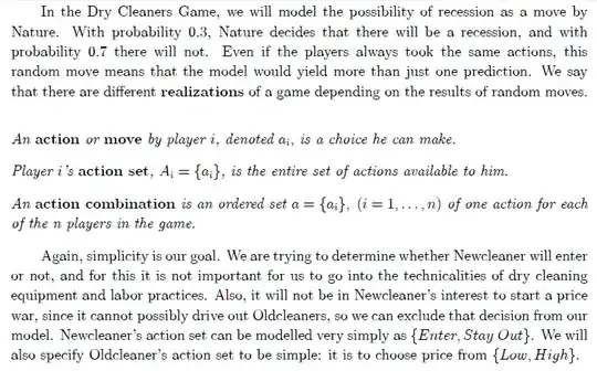

In the explanation given above, it may appear that mixing is occurring over actions. This is not a correct interpretation. It is technically incorrect because the player is not mixing over actions but mixing over strategies. This is because a player chooses strategies, not actions. A strategy is a plan that denotes that actions that a player takes in any and every contingency. We can think of it as mapping information sets to actions. This is important because we would like player 1's actions to depend on the state of nature---we want them to depend on which game he/she is playing.
For reference, we can find definitions of actions and strategies in the first chapter of Rasmusen's book, Games and Information (4th edition). The relevant text is given here:
enter image description here enter image description here enter image description here
What are the sets of strategies considered in each method?
In the case of the game that you have given, the pure strategies available can be written succinctly (LL, LR, RL, RR), as you have already done in method 2. Therefore, the method that you described in method two mixes over the pure strategies, with probabilities: $a$, $b$, $c$, and $1 -a-b-c$.

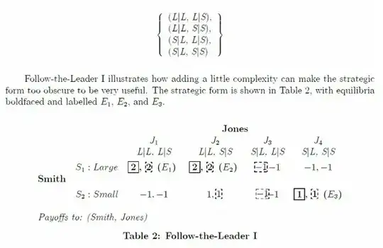

The following game is again take from Rasmusen's book. Suppose that in this game Smith moves first.
Then, Jones must choose among 4 strategies. In each of these strategies, he specifies his actions in each contingency. The 4 strategies are listed here and the game is represented in strategic or "normal" form.
There are three equilibria, denoted $E_1$, $E_2$, and $E_3$. If we were simply interested in the Nash equilibria of this game, we would include all of these equilbria. However, if we are interested in only the subgame perfect equilibria, we would only want $E_2$. That is because $E_1$ and $E_3$ involve non-credible threats.
I believe that if we were to try to solve this game using method 1, we would not be able to identify all three of these equilibria.
