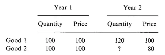

I am solving the following problem (from Exercise 2.F.3 (b) in MWG) and I got confused by the weak axiom of revealed preference and the definition of the revealed preference relation. Here is the exercise question:
Question
You are given the following partial information about a consumer's purchases. He consumes only two goods. enter image description here Over what range of quantities of good 2 consumed in year 2 would you conclude that the consumer's consumption bundle in year 1 is revealed preferred to that in year 2?
My Methods
I have two pieces of thought about this exercise. The first one is based on the weak axiom of revealed preference, and it does work. However, the second one, which is based on the definition of the revealed preference relation, does not work. Let me elaborate it:
Denote $\mathbf{p}^1 = (p_1^1,p_2^1) = (100,100)$, $\mathbf{p}^2 = (p_1^2,p_2^2) = (100,80)$, $w_1 = 100 \times 100 + 100 \times 100 = 20000$, $w_2 = 120 \times 100 + 80y = 12000 + 80y$, $x(\mathbf{p}^1,w_1) = \{(100,100)\}$, and $x(\mathbf{p}^2,w_2) = \{(120,y)\}$, where $y$ is the quantity of consumption of good 2 in year 2.

Hence, we must have that, when facing the price-wealth combination $(\mathbf{p}^1,w_1)$, both $x(\mathbf{p}^1,w_1)$ and $x(\mathbf{p}^2,w_2)$ are affordable, and that $x(\mathbf{p}^1,w_1)$ must not be affordable at the price-wealth combination $(\mathbf{p}^2,w_2)$. Therefore, \begin{align*} &\mathbf{p}^1 \cdot x(\mathbf{p}^2,w_2) = 100 \times 120 + 100y \leq 20000,\ \text{and}\\ &\mathbf{p}^2 \cdot x(\mathbf{p}^1,w_1) = 100 \times 100 + 80 \times 100 > 12000 + 80y. \end{align*} These inequalities gives us $y < 75$, which is the correct answer.

Based on this definition, I tried to solve this exercise as follows: Suppose that $x(\mathbf{p}^1,w_1), x(\mathbf{p}^2,w_2) \in B_{\mathbf{p}^1,w_1} = \left\{z \in \mathbb{R}_+^2: \mathbf{p}^1 \cdot z \leq w_1\right\}$. Then, $\mathbf{p}^1 \cdot x(\mathbf{p}^1,w_1) \leq w_1$, which is always true; and $\mathbf{p}^1 \cdot x(\mathbf{p}^2,w_2) = 100 \times 120 + 100y \leq 20000$, which implies that $y \leq 80$. For $x(\mathbf{P}^1,w_1)$ to be revealed preferred to $x(\mathbf{p}^2,w_2)$, we need $x(\mathbf{P}^1,w_1) \in C(B_{\mathbf{p}^1,w_1})$ but $x(\mathbf{P}^2,w_2) \notin C(B_{\mathbf{p}^1,w_1})$. However, this condition is automatically satisfied, because in the context of Walrasian demand, $C(B_{\mathbf{p}^1,w_1}) = x(\mathbf{p}^1,w_1) = \{(100,100)\} \neq \{(120,y)\} = x(\mathbf{p}^2,w_2)$, no matter what $y$ is. So, I concluded that $y \leq 80$ would make $x(\mathbf{p}^1,w_1)$ be revealed preferred to $x(\mathbf{p}^2,w_2)$.

Let ${\cal B}$ be a collection of choice sets and let $C$ be a single valued choice function, picking one item $C(B)$ out of every set $B \in {\cal B}$.
Let $x$ be revealed preferred to $y$ if there is some $B \in {\cal B}$, such that $x,y \in B$, $x \in C(B)$ and $y \ne x$ (which implies $y \notin C(B)$. We can denote this by $x \succeq_R y$.
In the first part of our question you establish the conditions such that $x(p_1,w_1) \succeq_R x(p_2, w_2)$ and not $x(p_2, w_2) \succeq_R x(p_1, w_1)$.
For the second part of your question, you only check the condition $x(p_1,w_1) \succeq_R x(p_2, w_2)$.
Note that (in principle) the revealed preference relation does not need to be asymmetric. So the second part leaves open the possiblity that also $x(p_2, w_2) \succeq_R x(p_1, w_1)$.
Notice that the question asks: Over what range of quantities of good 2 consumed in year 2 would you conclude that the consumer's consumption bundle in year 1 is revealed preferred to that in year 2?
It does not ask over what range of quantities of good 2 is the consumer's consumption bundle in year 1 revealed preferred (as by definition) to that in year 2?

    Thanks a lot for your answer! However, I couldn't agree with you on that. Here is my thought, please correct me if I am wrong: In the second way, other than $x(\mathbf{p}^1,w_1)\succsim^* x(\mathbf{p}^2,w_2)$, I also checked that $x(\mathbf{p}^1,w_1)\in C(B_{\mathbf{p}^1,w_1})$ but $x(\mathbf{p}^2,w_2)\notin C(B_{\mathbf{p}^1,w_1})$ (although it's trivial as C(B_{\mathbf{p}^1,w_1}) is a singleton containing only x(\mathbf{p}^1,w_1)). Indeed, when $75\leq y\leq80$, we'd also have $x(\mathbf{p}^2,w_2)\succsim^*B_{\mathbf{p}^1,w_1}$. But it shouldn't be an issue, – Shenron Feb 09 '24 at 20:38
    (cont'd) because such a preference can only be "revealed" by the observed choice behavior $C(B_{\mathbf{p}^2,w_2})={x(\mathbf{p}^2,w_2)}$ when $x(\mathbf{p}^2,w_1),x(\mathbf{p}^2,w_2)\in B_{\mathbf{p}^2,w_2}$. Moreover, in the textbook (page 11 right after Definition 1.C.2), it says that "the revealed preference relation $\succsim^*$ need not be either complete or transitive." – Shenron Feb 09 '24 at 20:38
    (cont'd) Therefore, I guess the point here might be that the question implicitly assumed that the consumer's behavior is consistent (that is, it satisfies the weak axiom). (After all, in part (a) of the exercise, it asked over what range would his behavior be inconsistent.) Really sorry for this long comment, please let me know your thought. I really appreciate it! – Shenron Feb 09 '24 at 20:39
