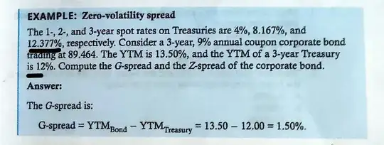

I'm preparing for CFA L1. I assumed that 3 year spot rate of treasury to be equal to the YTM of 3 year treasury bond. The Schweser notes define spot rate as below
Yields on zero-coupon government bonds are spot rates.
However in the below example from the Schweser notes, there's difference between 3 year spot rate and YTM of 3 year treasury bond. I'm trying to understand why. Thanks in advance enter image description here
  • Any bond that trades of par, will have a YTM different from spot (which is essentially every single bond). 3 year Treasuries also pay coupons and are not zero coupon. You can see a bunch of actual quotes for treasuries in this answer. – AKdemy Jun 29 '23 at 16:09
Spot rates for x-years in the future represent the difference (as a %) between the face-value of a bond and the purchase price.
I.e. If you buy a 2-year zero-coupon bond with a face value of £105 for £100, the spot rate would be 5%.
Yield To Maturity (YTM), however, refers only to coupon interest rates paid on bonds on an semi-annual basis. It doesn't account for any return on capital invested in the bond (if you buy it for less than the face-value).
