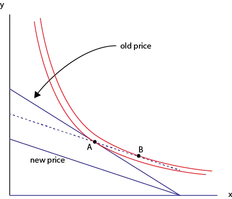

Here's a figure to explain:
Starting from the old price line, where the optimal consumption bundle is point $A$, we increase the price of $y$ to get the new price line.
The Slutsky compensation says that we have to give the consumer enough extra income so that he can afford to old bundle ($A$) at the new price. Thus, we shift the new budget constraint out to the dashed line.
The reason this "overcompensates" is that, taking the dashed line as the budget constraint, the consumer could afford bundle $B$, which gives him higher utility than he started with.

    @StanShunpike The Hicksian compensation is defined as being the compensation necessary to get the consumer back onto the original indifference curve (but not necessarily the original point on that curve). You can check in the above figure that one doesn't have to shift the dashed line out quite so far to get onto the original IC, but that this compensation would leave bundle $A$ unaffordable. – Ubiquitous May 03 '15 at 09:09
