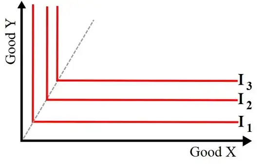

First, see this indifference curve:
Complements Fig 1: source
This setting is known as "complements". Because as you can see, adding one thousand units of good x (that is moving to the right), without adding good y (that is not move upwards) does not make you happier: you move along the indifference curve. Think of this as the left shoe and the right shoe. It is useless to have a thousand additional left shoes without adding a right shoe because they are perfect complements.

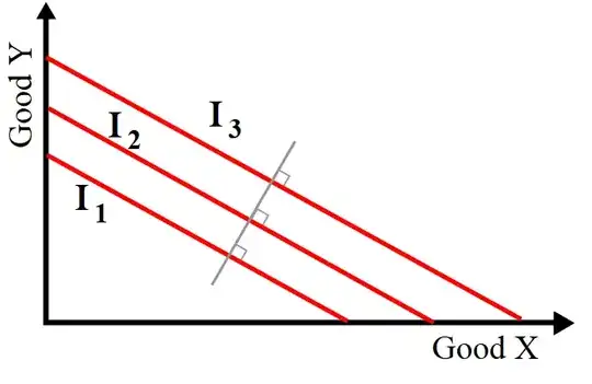

Now, look at this one: Substitutes Fig 2: source
This one is called "substitutes". It's the opposite case to the complements. You can think of this as beef and chicken. You can cook using only beef, or you can substitute and cook using only chicken. But you can cook with certain combination too, say 150 grams of beef and 100 grams of chicken beccause they are perfect substitutes (Sorry, i couldn't come up with a better example but this one makes the point).

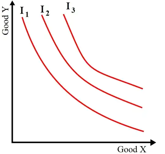

Now, this extreme cases make easier to imagine all the settings that are "in the middle". That is, two types of good that are not perfect complements neither perfect substitutes. Think of food and drinks. They can't be perfect substitutes because you can't have lots of food without drinks. The're not perfect complements either because the mix of food and drinks is not fixed. For this setting the cobb-douglas could be a nice approximation as can be seen in the next figure:

Now, the Cobb-Douglas utility function doesn't solve everything, as it imposes certain constraints by construction. For example, the line that goes from the origin through all the curves (the expansion path) is 45° and straight by construction: it cannot be changed. This means that as you get richer (even infintely rich), your preferences over this goods remains constant. The formal name is homotheticity or homothetic preferences. This is empirically false, as it has been shown that the richer you are, you use a smaller share of your income for food. With Cobb-Douglas preferences, this cannot happen. Translog preferences relaxes this assumption.
