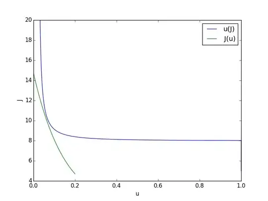

Given their calibration, they get two interesting steady state equilibria on the $(u, J)$ space: $(0.053, 11.3)$ and $(0.081, 9.5)$. My $u(J)$ graph seems to be correct as it goes through both these loci. The $J(u)$ line, however, seems to be "too small" given $u$.
The only object somewhat difficult to compute is $S(u)$. I have verified that my step of replacing actually works: I computed $w(u)$ using $\tilde S(u)$ and verified that $S(u, w(u)) == \tilde S(u)$ (up to a numerical approximation).
I am not asking for someone to find my mistake, but rather where to look for it: I have checked anything I could come up with and am somewhat stuck. For the interested, here is my Python code:

# plot J(u) and u(J)
plt.plot(u, JGrid, label='u(J)')
plt.plot(uGrid, J, label='J(u)')
plt.legend()
plt.xlabel('u')
plt.ylabel('J')
plt.show()

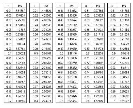

\begin{array}{| r | r |} \hline \hline \text {u} & \text {Jss} & \text{uSS(in J units)} \\ \hline 0.03 & 12.25 & 23.06 \\ 0.04 & 11.53 & 14.13 \\ 0.05 & 10.86 & 11.75 \\ 0.06 & 10.23 & 10.66 \\ 0.07 & 9.64 & 10.03\\ 0.08 & 9.09 & 9.62\\ 0.09 & 8.57 & 9.34\\ 0.10 & 8.09 & 9.14\\ \hline \end{array}
The $u$-nullcline stays always above the $J$-nullcline. I also "pushed" the $J$-nullcline by the factor $(1+\rho)$, i.e. the discrete version of the equation. But $\rho=0.003$, too small a mark-up, and so again there was no crossing. Therefore it appears that what went into the simulations of the authors is at some point(s) different from what the equations and the calibrated parameters (Table 2) appearing in the paper give us. Or, we are missing something.

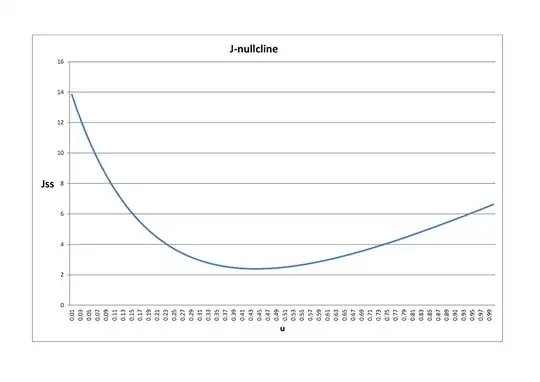

The $J$-nullcline
I checked the OP's code line by line, including the values of the calibrated parameters. I did not find any discrpeancy with what the paper gives. I then copy-pasted the code for the $J$-nullcline into Gretl, tweaking it only to match the local language. A note: the way various magnitudes are defined in the paper, we have
$$\psi_u > \psi_e \implies b >1 \;\forall u \implies \sigma = s/b < 1, \;\forall u$$
$$\implies \text {muOfU}\equiv \mu(\sigma(u)) = \min(1/\sigma, 1) = 1,\; \forall u$$
$$\implies \text {nuOfU}\equiv \nu(\sigma(u)) = \min(\sigma, 1) = \sigma, \; \forall u$$
**GRETL script**

I obtained the values
and the graph
From the above we can see that the $J$-nullcline, although it starts increasing, it never approaches again the value $8$, which is $\approx$ the low asymptote for the $u$-nullcline.
