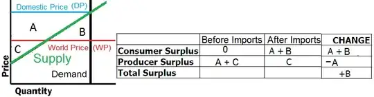

Please explain if this Best Answer is wrong? It claims that b) and c) are true. Yet my own work below shows a surplus of $+B$ after imports $\implies$ Gains from importing $\implies$ B and C are false.
Please feel free to correct my graph, but please also explain the intuition.
I wish to develop intuition, rather than be mechanically engrossed in graphs.
  • I agree with you. As shown in your graph, consumer surplus increases by A+B. Producer surplus decreases by A. Total domestic surplus increases by B. – NickJ Mar 18 '15 at 03:48

Perfectly inelastic demand means the consumer has no choice about buying the product or not: for some reason, he has to buy it. This means that consumer surplus is steady at 0: the consumer never pays less than he would be ready to pay, he always pays what he is asked to.
According to your (wrong) graph, the quantity reached would be at the intersection of WP and Supply. While this is true for producers, it is not for consumers: the supply curve should be bent to follow WP when crossing it.
You are right about producer surplus, which means we get a total surplus of $-A$, and a consumer surplus of $0$. There are no gains from trade and consumers do not benefit from trade.
