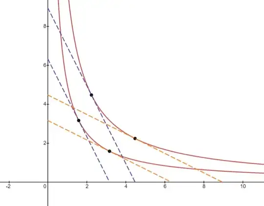

Now, what does the level of $K$ do? In some sense, higher values of $K$ take us on higher indifference curves. It is easy to see that the distance to go from one point on the indifference curve, say with price $p$, to another point, with price $p'$, will take more trade in the pool, the larger the value of $K$. If the value of $K$ is too low, I think prices will be quite volatile as small trades cause large price variation. Big values of $K$ will demand large amounts of trade to change prices, so prices may be more stable. (see picture below)
However, (from a theoretical point of view) it is not the case that you need to move $K$ in order to get a price change.
