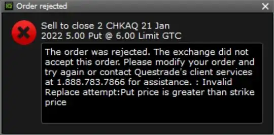

The screenshot below suggests thatan ITM put option's price can't overstep its strike price? Why or why not?
  • What is your definition of an "in the money" put option? A common definition is that the market price is below the put option's strike price. Note that neither of these are the actual price of the option. – Henry Jul 20 '20 at 16:24
  • @Henry Yes. You're correct about that definition. –  Jul 20 '20 at 19:43

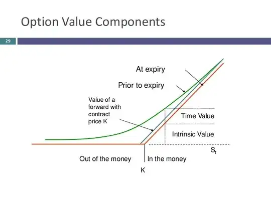

As you can see in the figure below (a call option, but it is the same idea), the time value of an option falls as the underlying price gets farther from the strike price. Therefore, when the ITM value is maximized you are as far as possible as you can get in one direction from the strike price, and we should expect the time value to be small. In fact, if you have a American option where you can exercise early, you will want to exercise this put option early if the price of the underlying ever reaches 0, because you can't make any extra money by waiting, which implies the time value is not just small but actually zero. NB: I believe this is only true when interest rates are positive. With negative rates it pays to wait just to avoid getting negative interest.
