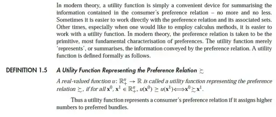

The definition of a utility function is given as follows (from Advanced Microeconomic Theory by Jehle and Reny, 2011): enter image description here
