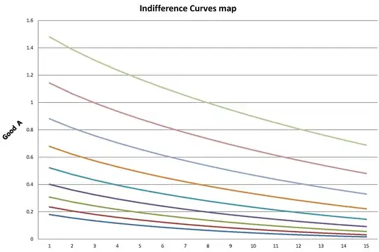

Perhaps you can consider something like
$$U(A,B) =\ln\left[aA^k + bB^h\right]$$
and all four parameters positive. For example, for values, $a=5, k=0.4, b=0.2, h=0.8$ the indifference map is
My conjecture is that for $0<h<1$ you may be able to have all the standard setup together with inferiority of $A$ (and for suitable values of prices and the other parameters of course). Find the first order conditions, substitute for $B$ in terms of $A$ in the budget constraint, and use the implicit function theorem to determine the conditions on the parameters required for $\frac {\partial A^*}{\partial y} <0$. And don't forget to check whether these conditions are compatible with the second-order conditions for utility maximization.

    Doesn't $U(A,B) =\ln\left[aA^k + bB^h\right]$ gives the same preference ordering over bundles as $U(A,B) = aA^k + bB^h$? That's just Cobb-Douglas-like preferences after you take the log which should not show inferiority but rather constant budget shares. – BKay Feb 19 '15 at 12:45
    @BKay's Cobb-Douglas utility functions represent separable preferences. As I wrote in my answer, it is necessary (although not sufficient) to have non-seperability, in order to be able to have inferiority. And this specific functional form, unlike Cobb-Douglas forms, has this non-separability property. Without the logarithm, it doesn't. I leave it to anyone interested to explore it further. – Alecos Papadopoulos Feb 19 '15 at 12:56
    Just to point out, as @Bkay has done, $\ln [aA^k +bB^h]$ is a monotonic transformation of $aA^k +bB^h$. So both represent the same preference. –  Feb 20 '15 at 15:20
  • @KenyLJ What matters for your question, which is about functional forms that can reflect inferiority, is whether the functional form is characterized by separability or not, (if one wants to maintain decreasing second derivatives of the utility function). – Alecos Papadopoulos Feb 20 '15 at 15:43
    Alecos, it is mind-blowing. What you are saying is that a person with exactly the same preferences (which they are, as it is monotonic transformation) may choose different consumption bundles, depending on how you would write her utility function. Please... –  Mar 10 '15 at 10:52
  • Actually, $U(A,B)=aA^k+bB^h$ is NOT Cobb-douglas like. It's a sum and not a multiplication (Cobb-Douglas is $U(A,B)=aA^kB^h$)...if you check the MRS you will see it's not the same, so these are not the same preferences. – Catarina RP Oct 07 '15 at 10:22

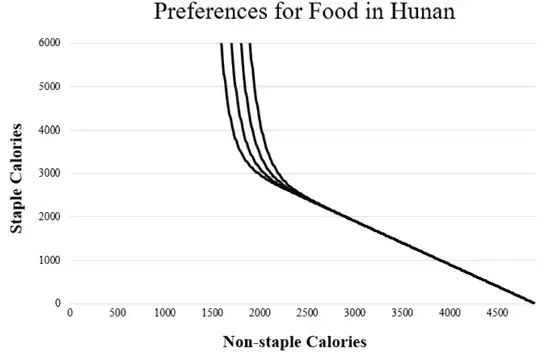

The paper "Hunger and the Demands for Cheap Dietary Staples of the Extreme Poor" provides an example of a utility function in which one of the goods is Giffen and it can be calibrated to characterize demands in the real world (https://ssrn.com/abstract=3728187):
$$u\left( b , m \right) = \left[ b + m - \bar{c} \right]^{\beta}\left[ m \right]^{1-\beta}$$
where $$b$$ is the Giffen good (the dietary staple).
When this utility function is maximized subject to the budget constraint $$p_{b}b + p_{m}m \leqslant i $$
the following demand for the dietary staple is found:
$$b\left(p_{m},p_{b},i\right)=\frac{i\left[ \beta p_{m} - p_{b} \right]+p_{m}p_{b}\left( 1-\beta \right)\bar{c}}{p_{b}\left( p_{m}-p_{b} \right)}$$
When this demand function is calibrated to account for the elasticities that Jensen and Miller (2008) estimate in Hunan, China, the values of the parameters become $$ \beta \cong 0.06, \bar{c} \cong 4,900, p_{m} \cong 3.107, i \cong 9,046 $$.
Then, it is a simple exercise to map the staple as a function of its price using Excel. It is recommended to create a grid for the price of the staple that goes between 0.4 and 1.7 with a spacing of 0.01 in between values. That is, the column that characterizes the values of the price of the staple should be 0.40, 0.41, 0.42, ... and so on. The result is the following graph:
Notice that, in this graph, the price of the staple is in the X-axis, and the staple is Giffen when its price is above 0.75.
The indifference curves of the calibrated version of this utility function look life this:
