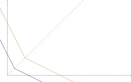

$u(x_1,x_2)=x_1+x_2+\min(x_1,x_2)=x_1+x_2 + \frac{x_1+x_2-|x_1-x_2|}{2}=\begin{cases}x_1+2x_2 \;\; \mathrm{for} \;\; x_1 \geq x_2\\ 2x_1+x_2 \;\; \mathrm{for} \;\; x_1<x_2 \end{cases}$
It looks like that (on horizontal axis $x_1$, on vertical axis $x_2$: enter image description here
It is neither convex, nor concave. Due to the absolute value function that is in a core of minimum function: Why is the absolute value function not differentiable at x=0?
