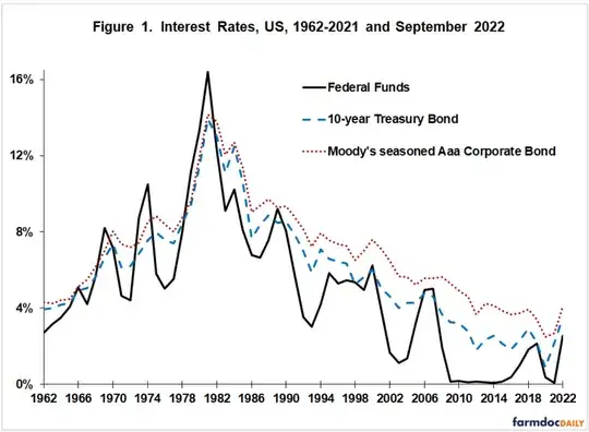

  • Medium to longer term rates: For example, the fed funds rate and the one-year Treasury rate track each other very closely. enter image description here On the other hand, the 5 year rate is a bit more independent but still moves up and down with the short term rates. The longer the tenor, the more important the investors' beliefs as to the direction of future interest rates and economic growth. Nonetheless, if the difference would become very large, say the 30 year US government bond would pay 50%, everyone would want to buy long term bonds (let us ignore default rates for now). Lots of buyers would drive up prices of bonds, thereby reducing yield again.
