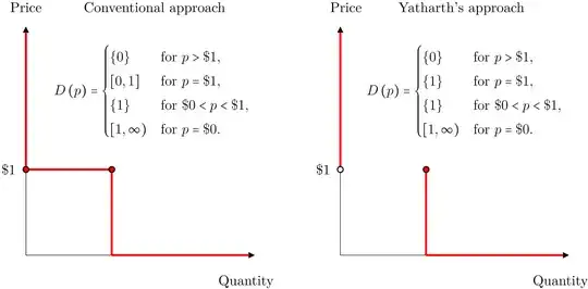

Then here are the graphs of the demand function under the two approaches:
The demand function is continuous under the conventional approach, but not under Yatharth's. (Nonetheless, under Yatharth's, it is lower semi-continuous.)
  • “As another example, under your approach, the demand curve will be discontinuous . . . . In contrast, under the conventional approach, it is continuous.” Could you explain why? – Yatharth Agarwal Jul 19 '18 at 20:36

  • Re discontinuous, thank for the diagram—I get it now! A follow up question, if you would be open to clarifying: Why is it important that the demand function be continuous in this way? (I only know about continuity for functions, but I suppose it is not too different for relations in general.) – Yatharth Agarwal Jul 20 '18 at 06:29
  • @YatharthAgarwal: In terms of economics, I don't think it's very important that the demand function be continuous in this way. But in terms of math/technicalities, It's just "nice" and usually leads to fewer inconveniences. –  Jul 20 '18 at 06:48
