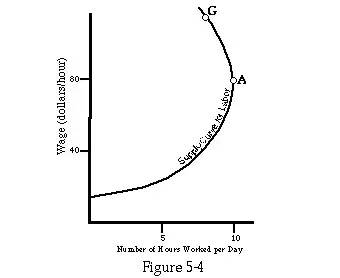

An increase in wages (say, from \$10/hour to \$11/hour) has two effects. It makes leisure more costly--each hour not worked means \$11 less income instead of \$10. That is an argument for working more hours at the higher salary. But at the same time, the increased wage means that the producer is wealthier--and is therefore inclined to consume more leisure. It is possible for the second effect to outweigh the first, in which case the increased wage causes a decrease in hours worked, as shown in Figure 5-4. This is called a backward-bending supply curve for labor; the backward-bending portion is from F to G (and presumably above G). The result, in the case of a single producer, would be a supply curve for goods that sloped in the wrong direction; for some range of goods, higher prices would generate less output instead of more.
This is not the first time we have seen a conflict between income and substitution effects. In Chapter 3, the same situation generated a Giffen good--a good whose demand curve sloped in the wrong direction. I argued that there were good reasons not to expect to observe Giffen goods in real life. Those reasons do not apply to the backward-bending supply curve for labor.
One of the reasons was that while we expect consumption of most goods to go up when income goes up, a Giffen good must be a good whose consumption goes down with increasing income--an inferior good. Indeed, it must be so strongly inferior that the income effect of an increase in its price (which, since we are buying it, is equivalent to a decrease in real income) outweighs the substitution effect. Our labor is something we are selling, not buying; an increase in its price (the wage rate) makes us richer not poorer, and so inclined to buy more leisure. So the backward-bending supply curve for labor only requires leisure to be a normal good.
