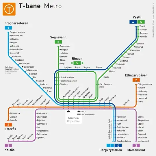

As an example, let's look at Oslo, the simplest of the three:
Imagine that you're travelling from Østerås (orange, left) to Ellingsrudåsen (orange, right). No transfers required – route 2 takes you all the way.
But if you're travelling from Østerås to Mortensrud (purple, bottom right), you would have to transfer from route 2 to route 3 at some point.

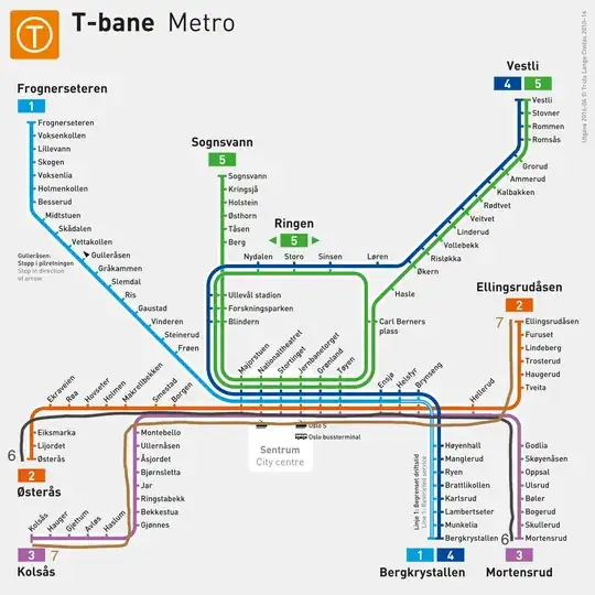

Let's imagine that we take some of the capacity from routes 2 and 3 to serve routes 6 and 7. Route 6 (gray) serves Østerås-Mortensrud, and route 7 (brown) serves Kolsås-Ellingsrudåsen:
With this design, some transfers could be avoided. If we added enough routes, many more transfers could be avoided. Granted, we would have to wait longer for a route that went exactly to the station we want to go, but we would always have the option of taking the first train and then changing like before.
(Note that I'm not suggesting adding new infrastructure, just using the existing one differently.)

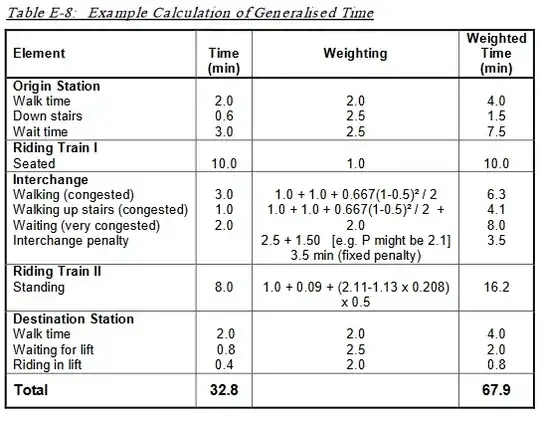

The people who do the planning do explicitly account for the value of time and convenience to transit users. At least, in all the systems I've worked on. (source: I have had jobs where I worked on exactly this, for London, for the Netherlands, and for international train travel)
Interchanges are modelled with penalties which cover:
  • the time taken to move from one platform to the other
  • the time to wait for the connecting train
  • and a penalty to reflect the inconvenience, which is calibrated through Stated Preference surveys.
Here's an example from the Business Case Development Manual used for evaluating costs and benefits for transport schemes in Greater London, page E-10, showing a penalty just for the interchange itself of 3.5 minutes of travel time. That's in addition to valuing the waiting and walking time at the interchange:
(disclosure: I developed some of the methods, and calibrated some of the numbers, in that manual)
