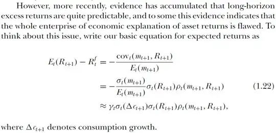

To keep things short, the idea behind predictability can be seen by an approximation of a special case (here we use a simple version of the Consumption Capital Asset Pricing model). This is from p.23 of Cochrane's book Asset Pricing (Revised Edition).
In this picture, $R$ are returns $R^f$ is the risk-free rate, $m_t$ is the stochastic discount factor, and $\gamma_t$ is risk aversion at time $t$. The conditional expected returns of future returns varies. It could vary based on any of the right-hand side variables. Empirical evidence seems to indicate that the variation is most plausibly coming from changes in risk aversion $\gamma_t$. If people become more risk averse, which they appear to do during recessions (seemingly for good reason), then they will demand higher expected returns per unit of risk that they take on. This means that information about the variables that determine risk aversion today give us information about tomorrow's returns.
Note that this doesn't imply a violation of no arbitrage. Sure, we can predict higher returns. But this simply reflects the fact that the "price of risk" has gone up. The amount of returns that I demand per unit of risk is changing. My prediction of higher returns is not gaining me any free lunch. It's just reflecting changes in my preferences.
