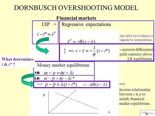

Stupid question: What do the phi and lambda from the equations above represent?
Ana
The equations you have are equilibrium conditions, while derivation (of course) starts with the demand equation and sets demand equal to supply. Then:
  • $\varphi$ ($0<\varphi<1$) is the income elasticity of money demand - the responsiveness of demand with respect to income
  • $-\lambda$ ($-\lambda <0$) is the interest rate semi-elasticity of money demand - the responsiveness of demand to the change in interest rates.
Semi-elasticity means that we care how much Y changes in percentages when we increase $X$ by one (increase by one, not by one percentage point).
emeryville
  • 6,935
  • 41
NFilip
To my understanding, $\phi$ and $\lambda$ are simply positive parameters in the Dornbusch model used to represent the linear (in logarithms) equilibrium condition in the money market.
$$ m - p = \phi y - \lambda i $$
is also known as the LM curve, in logarithms.
