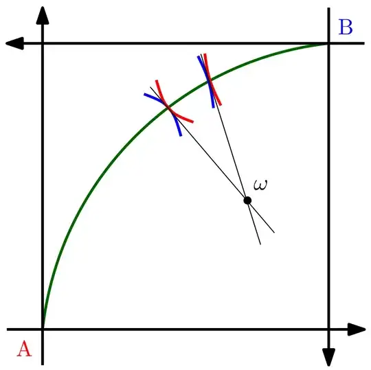

A graphical representation of the problem:
enter image description here Green is the set of Pareto-optimal points, red and blue are indifference curves, thin lines are budget lines.
