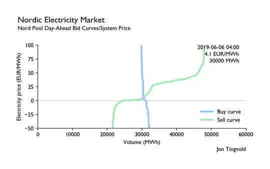

Nord Pool Bid Curves
Here is a plot of the bid curves on Nord Pool (the electricity market for Norway, Sweden, Danmark, Finland, Estonia, Lithuania and Latvia) two weeks ago, when the price was especially low, just 4.1 EUR/MWh, for one hour, 4am, at night. (You can find a video/animation of how the bid curves vary in the same period on YouTube.)
You can see that over 22 000 MW (MWh/h) of the power provided are willing to produce power no matter how negative the prices become. Around 10 000 MW of this is nuclear power. The rest is probably coal, some other slow responsive thermal power plants, and some producers that won't be bothered with adjusting their production (small power plants, etc.).
Ca. 10 000 of the power provided, 6200 MW of which is wind, bid around 0 EUR/MWh. Since it is impossible to store energy wind producers and hydropower producers without reservoirs are willing to sell for nothing, however, they can turn off quickly if prices becomes negative. Ca. 30 000 MW of the power provided are regulable power, mostly gas and hydropower from reservoirs, that bid around 25–50 EUR/MWh.
Notice also how insensitive consumers are to prices. Demand is slightly higher if the price becomes negative, but it is almost nothing, only ca. 1000 MW.
In the extreme event that prices would fall below 22 000 MW you can easily see how prices would spike down quite extremely. In the Nordic market(*) where much of the production is regulatable hydropower, this is very unlikely.
