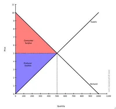

My class IB has just discussed allocative efficiency and hence consumer and producer supply. They explained the concepts with a diagram like this: enter image description here

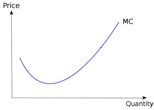

It all made perfect sense to me until it was mentioned that the supply curve can also be seen as a marginal cost curve. If this is the case, I don't understand why it is only sloping upwards. I know that marginal cost curves (at least at short-term) look something like... This But the curve in the first diagram is different.
Is is an oversimplification of a real marginal cost diagram, or am I missing something?

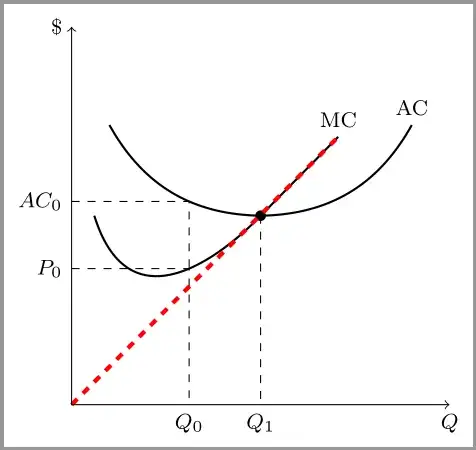

I'll offer a less algebraic alternative to Alecos's answer. In short, yes and no.
The "no" part
Normally the MC and AC curves would look like the following, with MC intersecting AC from below AC's minimum point. Suppose price $P_0$ were below this point. Then the firm would sell at a quantity below $Q_1$. But what does this imply for the firm's profit? On average, the firm would make $P_0$ per unit sold, but the cost per unit must be higher than $P_0$, i.e. at $AC_0$ if the firm is selling at $Q_0$. This means the firm would be making a loss (negative profit) and no profit maximizing firm would try to operate at this point; they'd be better off shutting down and get zero profit instead.
Therefore, a firm's supply curve should be the fraction of its MC curve that's above the AC curve, which is always upward sloping. The quantity $Q_1$ where a firm would start producing is sometimes referred to as the minimum efficient scale of production.
The "yes" part
In your demand-supply diagram, the supply curve starts from the origin. Imagine this is just as having the red-dash line in the following diagram "approximating" the part of the MC curve that is below AC --- filling the gap, so to speak.

  • @AlecosPapadopoulos: I agree that's the case when fixed costs are non-sunk. For sunk fixed costs, well, they should not feature in a firm's decision. So it's WLOG to have supply curve starting at origin. At any rate, the part of the supply curve between the origin and the AC-MC intersection is just an approximation; there's room for a little hand-waving. – Herr K. Nov 02 '17 at 01:52
  • @HerrK. But why can't I just sell based off the average cost and not the MC? That way there's no change of making a loss. – Andy Nov 02 '17 at 11:36
  • @MainManAndy: MC reflects the cost of additional units produced, and thus setting price equal to MC more accurately captures the increase in costs of production. Moreover, a firm's objective is to maximize profit, not to avoid losses. Pricing based on AC is inconsistent with this profit motive. – Herr K. Nov 02 '17 at 18:45
