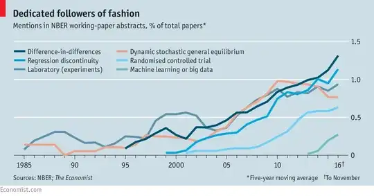

There was a recent post in The Economist about the emergence of machine learning into standard economic papers. They produced a nice graph, reproduced below:
Albeit machine learning is confounded with big data, it shows a rise in their use since 2014. Surely, this is a very narrow selection of the literature (NBER working papers, and only abstracts), but is a start.
