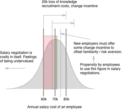

I'm the managing director of a company in which we run appraisals every 6 months. Each time we negotiate salary I have in my mind's eye this picture...
Assuming the 'correct' salary for an employee is 70k, there's an incentive to offer slightly more. 'Slightly more' because there's some error in estimating the market rate and the costs of getting this wrong are high. I've added a staff churn costs of £20k/yr for getting this wrong based on loss of knowledge, morale, recruitment costs and what I refer to as a 'change incentive' for the replacement employee. The change incentive is the amount you must offer a new employee beyond their current rate (market rate?) to discount the loss of familiarity and to take on the risk of joining a new employee.

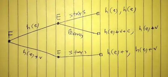

A) Firm offers a wage
First, the case where the firm ($F$) offers a wage and the employee ($E$) decides what to do:
The first outcome refers to the firm's cost, the second to the employee's wage. We have assumed that if the employee is offered the new hire premium it stays with the firm. Let $p_l$ be the probability that the employee will leave if he is offered $h(e)$ only. The firm faces the following expected costs:
$$EC [h(e)] \equiv EC_{A1}= (1-p_l)h(e) + p_l[h(e)+v+c] = h(e)+p_l[v+c]$$
$$EC [h(e)+v] \equiv EC_{A2} = h(e)+v$$
Then in order for the firm to nevertheless offer $h(e)$ it must be the case that
$$EC_{A1} < EC_{A2} \implies h(e)+p_l[v+c] < h(e)+v$$
$$\implies p_l < \frac {v}{v+c}$$
and it should offer $h(e) + v$ if the inequality points to the other direction.

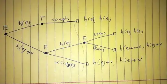

Let's move now to the OP idea, to tell the employee to ask for a wage. Here we have
B) Employee asks for a wage
Here too the first outcome is the firm's cost. We have allowed for the possibility that the employee asks only the efficiency wage. This is crucial.
Since we are in the "decision about the process structure" phase, we assign some probability $p_e$ that the employee may actually ask for just the efficiency wage. This is important.
It is also important to note that, assuming that the employee has asked for $h(e) + v$, while the criterion for whether the firm should accept or counter-offer only $h(e)$ has exactly the same expression as before, we are looking at a different probability. Here the firm must decide whether the employee is "bluffing" (he does not have an offer from another firm), or not. This is a different probability than the previous one. Here, the firm has additional information (for better or for worse), and so it has to make a difference assessment. Call the probability of not bluffing $p_c$.
We have that
$$p_l < p_c$$
because the former is a conditional probability of the same event ("the employee leaves"), while the latter is the unconditional probability. Keep this inequality for later.
Assume that the firm has estimated somehow ("if the employee asks for $h(e)+v$ there is $p_c$ probability that he will leave if I counter offer $h(e)$ only). If this is estimated, then the firm already knows what it will do if the employee asks for the new hire premium -and it will depend on the specific values of the various quantities here.
So given an estimate for $p_c$ we are looking at two possible expected costs for the firm
B.1. The firm will counteroffer $h(e)$ here the expected cost is
$$EC_{B1} = p_eh(e) + (1-p_e)\cdot [(1-p_c)h(e) + p_c(h(e)+v+c)]$$
$$= h(e) + (1-p_e)p_c(v+c)$$
B.2. The firm will accept $h(e)+v$
$$EC_{B2} = p_eh(e) + (1-p_e)(h(e) +v) = h(e) + (1-p_e)v$$
