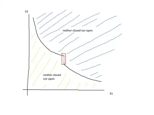

Because of the way the lower and upper contour sets are constructed, you can think of all the convergent sequences in the upper contour set as $\{x^n\}^\infty_{n=1}$ and all the convergent sequences of points in the lower contour set as $\{y^n\}^\infty_{n=1}$. In this case, all $x \succsim y$.
But it's not the same way for discontinuous preferences! Just try and draw discontinuous preferences where the contour sets are closed.
(enjoy that masterpiece)
Any convergent sequence to that open boundary there is trouble.

    Kitsune, thank you for the answer plus the picture; I am thoroughly appreciating the latter one as well :) While I re-read your answer to let it sink in, I at first didn't fully understood their definition of the contour set. Strictly set notation-wise speaking, for example lower contour set, denoted as $L(x)={y\in X:x\succsim y}$. It got me confused, b/c we have $x$ in $L(x)$ but are talking about all other bundles $y$ such that condition. So pictorially, I understand this is basically the LHS lower half of the indifference curve in the case of $\mathbb{R}^2$. – Frank Swanton Jun 18 '16 at 05:26
