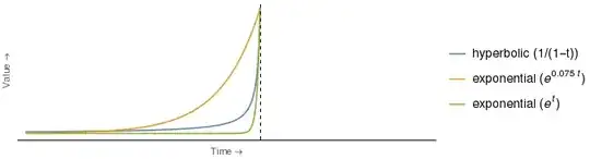

The figure that the excerpt refers to looks somewhat like the one shown below, the most notable difference being that I've added the legend to indicate which curve is which2, together with the analytical form of the actual discount functions used3.
Mathematica graphics
But it seems to me that the argument, as presented above, is spurious. It is clear that whose valuation would be more depressed, depends on the time. Therefore, the exact same argument with the roles of Ms. E and Ms. H reversed, would work for any timepoint between the point at which the curves intersect and the vertical axis.
In fact, for certain choices of coefficients for the hyperbolic and exponential curves, the exponential curve is more depressed than the hyperbolic one for all time points. For example:
It turns out that the green exponential curve above intersects the hyperbolic curve at only one value of $t$, namely $t = 0$ (i.e. at the time indicated by the vertical axis). For all $t < 0$, the green exponential curve is strictly below the hyperbolic one.
This means that, if Ms. E's exponential discounting curve were the green one, then Ms. H would be able to quickly immiserate her by applying the strategy described in the excerpt, and this would be true irrespective of the length of the time interval between the buying and the selling back of the winter coat.
