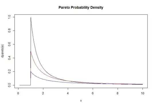

You can use R to to draw a Pareto curve. Here is a useful vignette using the package VGAM.
require("VGAM")
x <- seq(0.1, 10, length = 1000)
plot(x, dpareto(x, scale = 1, shape=1), type = "l"
, xlab = "x", ylab = "dpareto(x)"
, main = "Pareto Probability Density")
lines(x, dpareto(x, scale = 1, shape=.5), col = "red")
lines(x, dpareto(x, scale = 1, shape= .2), col = "blue")
