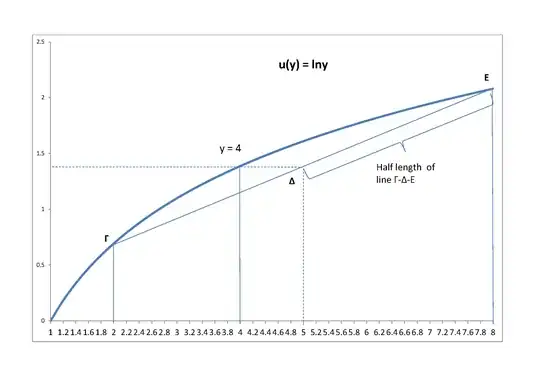

I close with the diagram of the logarithmic case
Assume $y=4$. Then $y/2 =2, 2y = 8$. The line $Γ-Δ-Ε$ is the line on which the expected utility from "Switch" will lie. Since nature plays a $50-50$ strategy, it will actually be at point $\Delta$, which is the middle point of $Γ-Δ-Ε$. At that point with logarithmic utility, we get exactly the same utility from "Don't Switch", i.e. $\ln(4)$ for this numerical example.
