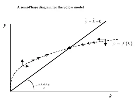

Following the conversation with user @denesp at the comments of my previous answer, I have to clarify the following: the usual graphical device we use related to the basic Solow growth model (see for example here, figure 2) is not a phase diagram, since reasonably we call "phase diagrams" those that contain zero-change loci, identify the crossing points of them as fixed points of a dynamical system, and examine their stability properties. And this is not what we do for the Solow model. So it was careless use of terminology from my part.
Nevertheless we can draw a "semi-Phase diagram" for the Solow growth model, in $(y,k)$ space. Understanding the symbols as "per efficiency unit of labor" we have the system of differential equations (while $y=f(k)$)
$$\dot k = sy - (n+\delta+g)k$$
$$\dot y = f'_k(k)\cdot \dot k$$ Writing the zero-change equation as a weak inequality to show also the dynamical tendencies, we have
$$\dot k \geq 0 \implies y \geq \frac {n+\delta+g}{s} k$$
$$\dot y \geq 0 \implies \dot k \geq 0$$
So this system gives a single zero change locus, a straight line. No crossing points to identify a fixed point What can we do? Draw also the production function in the diagram, since, in reality, the $(y,k)$ space is unidimensional, not an area, but a line. Then we get
The vertical/horizontal arrows indicating the dynamical tendencies come properly from the weak inequalities above (both $y$ and $k$ tend to grow when above the zero-change locus). Then, since $y$ and $k$ are constrained to move on the dotted line (which is the production function), it follows that they move towards their fixed point, no matter where we start. Here the production function graph represents essentially the path towards long-run equilibrium, since convergence is monotonic.
