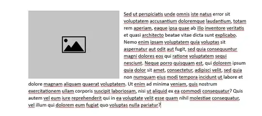

I know KDP can upload Word documents. I have a large part of my book completed and I want to include images. I know they will be displayed in black and white on a Kindle, but what about formatting? I want to be able to wrap my text around an image like the sample I have provided below. Will KDP respect/handle this formatting?

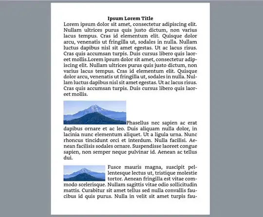

This Kindle help page info might provide options: Kindle Create page. That web link (in the "Add or change images" section) suggests to upload .doc into Kindle Create, save it, and THEN insert your images/charts into that open file and place each image where you need them (it allows formatting the images there).
I have attached an example where the top image was already on the .doc page when it was uploaded into Kindle Create, whereas the lower image was inserted inside of Kindle Create and formatted there. For unknown reason Kindle dumped the formatting on the top image (the image that was already in my Word document).
Inserting images into Kindle Create seems like a convoluted method (especially if the text document has a ton of charts and images that you prefer to refine into place before going into Kindle Create). Ideally building it all in your favorite software (whether Adobe / Corel / MS Word etc.) is the most preferred method by book/eBook designers.
Other web sources (including Kindle help page) indicate it is feasible to set the images/charts in your Word document (and formatting it all there) before uploading the document into Kindle Create.
Hopefully another person can comment here with a solution that'll work via MS Word (your preferred software), since I primarily use other software to reach final eBook stage.

example document with two images
