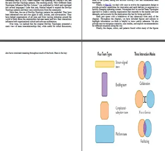

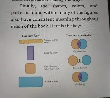

I've used Calibre to convert Mobi/Epub to PDF. The overall output is good, however, the image is always not in good shape. For example,
How image shows in Kindle reader (Android app)
How image shows after conversion in PDF (w/ Calibre)
How can I keep the image not distorted when converted to PDF?

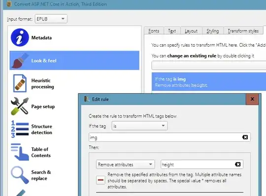

There's a much simpler way. The culprit is in the height tag, which needs to be removed. Once removed, with only the width tag, browser computes the proper aspect ratio.
To do this, add a rule in "Look & Feel/Transform HTML" section which reads:
  • if tag is img
    • remove attribute "height"

    Thanks. Converting from EPUB to PDF give me the same result; and there is no exact settings in Calibre (I only find image cover ratio, but it can't handle images for every other images) – ZK Zhao Oct 30 '19 at 02:16
  • Rename the file extension of the epub file from .epub to .zip and then unzip the files. Find the image file and verify that it's dimensions are the correct ratios. Assuming that is so, then the problem is with the css. (I provide some mobi friendly CSS for images here: http://www.imaginaryplanet.net/weblogs/idiotprogrammer/2019/06/random-publishing-tips-by-myself/ – idiotprogrammer Nov 01 '19 at 12:22
  • Formatting images for Kindle is REALLY HARD! It sounds as though the original mobi used css which was suitable for one display width, but not for another. One of the problems is that mobi css does not support the max-width property.. – idiotprogrammer Nov 01 '19 at 12:24
  • This seems to me to be a common problem - have the same exact problem when converting from EPUB to PDF via Calibre. All images are stretched vertically and their proportion is never maintained, even if two settings are set: 1) PDF Output -> Preserve cover ratio (useless; only intended to keep same aspect ratio in the output file); 2) Page setup -> Output profile: "Tablet" (whose description states "does no resizing of images". Nothing works; images are always resized. – alelom Jan 04 '21 at 16:32
