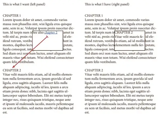

exampleUsing calibre and epub3 I'm using popup footnotes (with epub:type). In some of the footnotes I present links (ex. a link to Chapter 2) to the main text. This referred text should not be presented in the popup windows itself (se right panel) - the links should direct to other chapters in the ebook (se left panel).
At the moment it seems that the referred text (ex. Chapter 2) are shown directly in the popup window (see right panel). How can I change this, so the links bypasses the popup window?
The problem occurs on a iMac in iBooks 1.16.
Regards, Dan
Dan

  • I have updated my question – Dan Oct 28 '18 at 07:58
  • Idiotprogrammer: Im using the coding presented in the guidelines and the footnote-popup itself works fine. My problem only concerns the result of the internal links. – Dan Oct 28 '18 at 08:05
