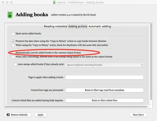

In Preferences - Adding Books in Adding Actions tab there is a preference Automatically convert added books to the current format You need to click that off. The default is off.

  • Thanks for the answer but that’s off already. Digging a little deeper, dragging the book onto Calibre does the following:

  • clicking it off is not woking at all – Vidy Videni Oct 06 '19 at 00:47
