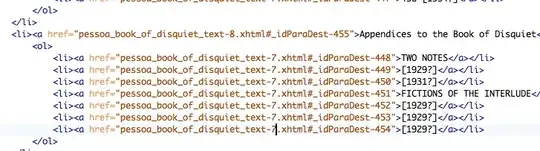

I hit the same problem today. The problem appeared to be that the links in the nested (or
  • for EPUB3, no difference) pointed to locations other than the parent element.

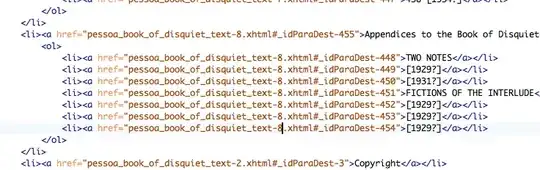

    So this code caused the same error you got: enter image description here The key is that, because of a quirk in InDesign export, the section head was created as a separate file. I went in and put the items into pessoa_book_of_disquiet_text-8.xhtml, like so
    enter image description here Voila, no more error. It looks like for Kindle, nested content has to be in the same file as the parent. To be clear, I had to move all the content into the file, not just change the names.
    Does this fix your problem?
