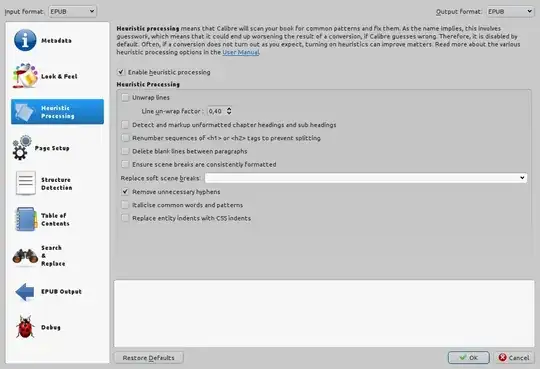

If the book has not a DRM and you are free to edit/convert it, you can use Calibre to convert to the same format (i.e. you can use an .epub as a source file and still convert to an .epub output.
In the Heuristic processing tab make sure to enable both the processing and Remove unnecessary hyphenation; if you want you can also enable other options here if you need to.
This method use the source document as a dictionary to verify if the hyphenated word is also spelled as a single word. Of course, if a given hyphenated word has a single occurrence it won't be corrected. From Calibre user manual:
calibre will analyze all hyphenated content in the document when this option is enabled. The document itself is used as a dictionary for analysis. This allows calibre to accurately remove hyphens for any words in the document in any language, along with made-up and obscure scientific words. The primary drawback is words appearing only a single time in the document will not be changed. Analysis happens in two passes, the first pass analyzes line endings. Lines are only unwrapped if the word exists with or without a hyphen in the document. The second pass analyzes all hyphenated words throughout the document, hyphens are removed if the word exists elsewhere in the document without a match.
If you happen to have the the source .pdf, where all hyphenated words are placed at the end of their respective lines, you can use the Search & Replace tab to add another tweak (I've personally tested and used it many times).
You must enter -<br> in the Search box and leave completely blank the Replacement one, and be sure to click Add to, well, add the rule to the conversion. This only works, as I've stated, if the hyphens are correctly placed at the end of their lines, so, in most cases, you need to have access to the source file. You can also click on the Wizard button to open a preview of the file, where you can preview what your source regex code (in this case -<br>) will select and delete (because we left blank the replacement box).
