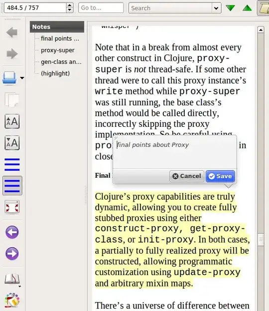

You can add annotations with a work-in-progress-extension for calibre:
The source includes code to handle Kindle notes, but not any for Kobo. However it should be possible to add that starting e.g. from this kobo specific code.

  • This seems to go beyond my knowledge and expertise. Maybe my best option is to wait until someone creates something that I can use without much tampering. – Sekhemty Jan 05 '14 at 14:12
  • Even getting the annotations to run just in ebook-viewer, would require you to run the development version of calibre. I have done that for a while when I wrote the DjVu plugin, but since then I rather prefer the comfort of a tested, released version. – Anthon Jan 05 '14 at 14:45
