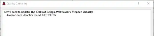

You can use Quality Check to check it one more time to be sure.
Quality Check => Fix => Fix ASIN for Kindle Fire (work for other versions of Kindle).
Click "View log", and it should be something like this: "Amazon.com identifier found: [ASIN number]
